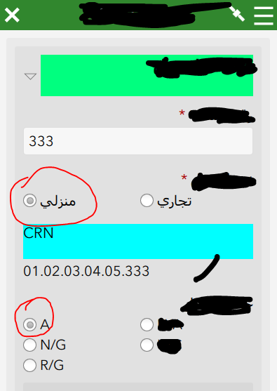

Dears,
I am struggling for a while now, trying to edit Repeat questions in the Inbox of my survey.
The answers are all not editable [Dimmed] [Greyed] so I cannot edit any answer if it is in the Repeat.
While I can still edit answers if its not inside the Repeat.
I used [query allowupdates=true] in [bind::esri:parameters] column on beginrepeat row.

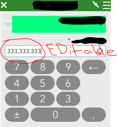

egyptgas
Lance Thanks for the prompt response,
Actually I am using SurveyConnect & fieldapp version 3.5.x.
Also I checked using [Always use latest version] in MySurveys.
When I use allowUpdates=True without the query parameter it doesnot work at all.
I made sure that [query allowUpdates=True] is retrieving the answers but [Greyed] so I cannot edit.
I publish the survey from connect >> download survey in fieldapp >> collect answer and submit >> refresh inbox Tab in fieldapp >> retrieve answers [some are editable and some are not as noted in the pictures].
I need to know if it is allowable to edit repeats [relatedTables] retrieved from inbox or not ?
BTW I am following the steps mentioned here https://community.esri.com/thread/204276-repeat-questions-in-inbox-not-showing but still cannot edit the repeat answers.
