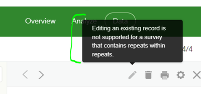

Hi,
I am attempting to edit records in Survey123 on the web on the data tab. When I click to edit a record I receive the following message, "edit existing records is not supported for surveys that contain repeats."  The survey was created in Survey123 connect I have checked the settings for the feature layer in AGOL and the settings are set to allow attribute and geometry updates. How can I edit records in Survey123 on the web with repeats. Thank you.

Did you add
query allowUpdates=true
to the
bind esri paramaters column
on the begin repeat row?
If not try that.

Yes, I did do that.

Did you find any solution to this? I'm currently running into this issue, regarding nested repeats.

I think this a limitation with web forms but not sure.  Try in an app and see.  Note you can get the app for windows.

Thanks for responding, Doug. I created a new post to elaborate on the issue further since this was an old thread. Been testing many different things today to try to find a workaround that will work for the user's needs.
