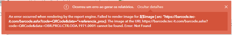

Hi @Jim-Moore. Thank you so much for your help. That configuration works and it adds the value of my_field to the url, but it automatically removes the question mark (?), so it drives the url invalid. I've tried to substitute the question mark with ? and it doesn't remove it, but it still gives me an error when printig the report, even though the generated url is valid:
Hi @CarlosSousaFerreira thanks for raising this. On further discussion with colleagues, this is a known issue: a question mark (?) in an image source URL in the template will cause a print error. We're working on resolving this issue for the next release. Perhaps surprisingly, the issue does not occur if the question mark is in the answer to a question, so in the meantime, the workaround is to use the method described above, i.e. concatenate the URL in a separate text question and then use the question name as the image source. We'll endeavour to update this post with any developments. The fix should hopefully be included in our next beta website update on EAC as well. Best, Jim
OK. Thanks! Hoping to see the fix for this in the next version. Take care, Carlos
