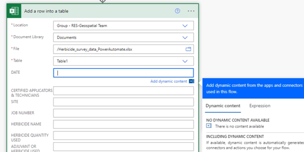

Hello,
I am working with Power Automate for the first time, hoping to automate the process of taking data collected in Survey123 and automatically populating an excel spreadsheet. I've been following this workflow by @IsmaelChivite
https://www.esri.com/arcgis-blog/products/survey123/constituent-engagement/instantly-load-survey123-...
However, even though I believe I've set the table up correctly (and it's clearly pulling in the column names) I am not able to enter any field values from dynamic content
Any idea what might be causing this and how I can address it? Thanks in advance!

In case anyone comes across this post in the future, wanted to update that I was able to solve the problem by using the Templates button instead of "Create" as the documentation/blog post showed.
When I set up the flow through the template, the dynamic content populated without issue.

Wondering if you're seeing this issue lately? It appears it's back for me in the last few weeks. Now my "flow checker" side bar says "Url of ArcGIS Enterprise is required". Adding new data connections and reestablishing  the connection doesn't seem to solve the issue either. Very frustrating.
PatriceMoore2
Just wanted to pop in here to say it's happening to mine as well and thanks for posting!
RuchiraWelikala2
Was able to resolve this by removing the default "Send an Email" operation and adding the Outlook operation "Send an email (V2)". This one works as it should. Hope that helps.
CarlisleHaworth1
Hi Katherine, I have also encountered this when my data connection to S123 is broken which does seem to happen periodically for unknown reasons. To resolve this, I go under Data>Connections and for the Survey123 Connection, click Switch Account. This will log you out of S123 and you'll just need to log back in.
MMcCleary
Thank you so much for your post. I had been struggling with this issue for far too long until I found your recommendation. Thank you this solved it for me.
