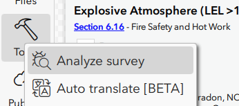

I highly recommend using the "analyze survey" feature in Connect. It would have warned you about this.
Additionally, I would also recommend ensuring your Connect is up to date. Please be aware that the stand-alone installer does not update itself. However, the Windows Store version of Connect does auto-update.
