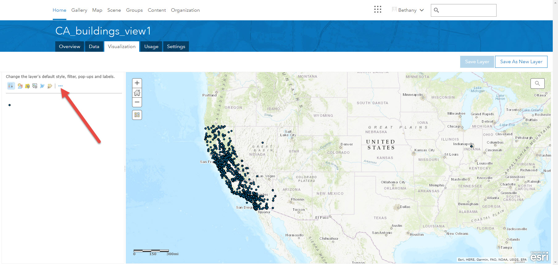

3) Go to the item details page of the hosted feature layer view > Click the "Visualization" tab
4) Click the ... icon in the table of contents menu
5) Click "Set View Definition" > "Define Features" > Here you can filter based on your attributes of interest
6) Then, when you export the csv for this hosted feature layer, it will only include your filtered features based on what you defined in the view definition in Step 5
