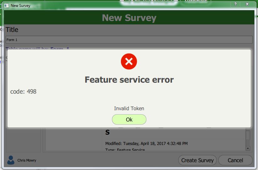

I am attempting to create a form in Survey123 Connect from an existing feature service from ArcGIS Online, but am getting a Feature Service Error (code: 498 Invalid Token). The Feature Service is added by a URL from ArcGIS Server. Does Connect currently support using existing feature services not created by Survey123? Is there some other issue that may be creating this error?

Hi Ismael,
My apologies for the lag in incorporating the lag in testing the work around in the link you provided, but for some reason, I'm still getting the same error "

Hi Chris,
To work with an existing service, there are some additional configuration steps:
1) The service must be secured (right now your showing the security setup of the server, not the individual service - in the Server Manager that is displayed as a lock icon in the service entry)
2) The service must then be registered with your ArcGIS Online or Portal account - when registering you will be prompted to sign in to your server.  Choose the option to Store Credentials.
3) You should see that the item created doesn't refer directly to your server's URL; instead, it's a proxy service that is attached to ArcGIS Online/Portal.  This is the URL to use when creating a feature service (it's just easier to use the 'Add New > Feature Service' option at this point than manually copying the URL over.
More instructions can be viewed at Survey123 help: connect to non-federated ArcGIS Server services
