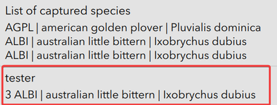

tiztrain
The count shows up but it does not concatenate it to a list and only displays the most recent value as can be scene circled in red below.
Whenever I try to concatenate in a join, this is the problem i run into.
