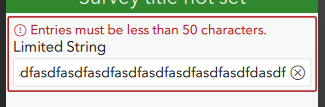

This is possible by making use of the constraint column. Simply put in a statement like this:
string-length(.)<50
Then use the constraint-message column to show
Entries must be less than 50 characters.
 Users exceeding the constraint will see the message.

I'm sorry, I should have read the entire thread, I'd have seen that. Well in any case, that method still addresses point B of the original question, in that it highlights questions for the end user without requiring the addition of notes fields.
It might be possible to have a single notes field validate the character counts on multiple other questions using a series of coalesce statements, but this is likely to be more complicated that just using constraints.
