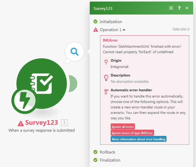

I published a survey using Survey123 Connect (v 3.1.126) for our Borough Parks department to submit a survey describing maintenance that they've done. I went to use webhooks with Integromat to generate an email to the department head whenever a survey is submitted and received this error:
I used the Survey123 beta button in Integromat, and tried it using the webhooks button, both with the same issue. Surveys previously published and webhooked (using the Webhook button) are still generating emails as they're supposed to, but any new surveys I'm publishing (or the one survey I transitioned to the Survey123 beta button) are not.
I thought the issue might be in that I was using Calculations on Geopoints in my survey, so I tried publishing a basic survey with one text field and one select_one field and had the same issue. Then I thought that it might've been the version of Survey123 I was using, but the issue persisted using v 3.2.126.
Basically, I'm wondering if there's a disconnect between Integromat and the newer versions of Survey123, or if there's extra something I need to do to get it to work again.

We are currently working on an update to the connector in Integromat which could be why it is currently not working as it was before. I see you are trying to get attachments also which is part of the new beta functionality in the connector.
Keep an eye out for any updates to the connector and hopefully this will resolve the issues you are having.

The Integromat connector has been updated to remove the attachments error. Can you please try again and let me know if you still have any issues.
You may need to create a new we hook from scratch and not use the existing one, just to ensure you are using latest connector.

I have both the same issues,
Regarding the GetAttechmentUrl issue, it is solved by uncheking the feature attributes sent in the webhook parameter of your survey in Survey123 website.
