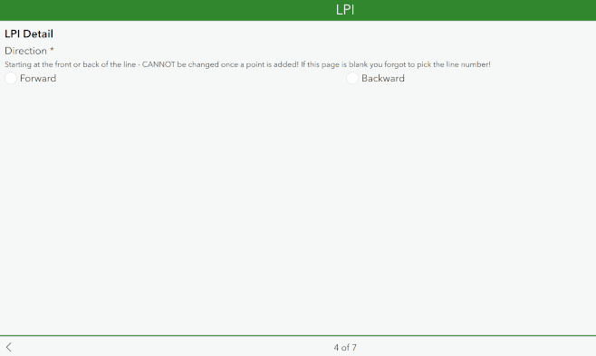

DougBrowning
MVP Esteemed Contributor
The closest I have got to this is to turn the field to read only once the question after it is answered.  This worked out fine since if you immediately make it read only as you propose, what if the user tapped by accident - they are stuck.  This way they can select the first question, can change their mind, but the second they fill out the next question it goes read only and locks in their answer.
Like here I am going read only as soon as they add a repeat.
