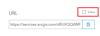

1.  Go to the item details of the feature service
2.  Scroll to the bottom and click View for the URL:

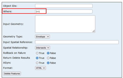

4.  Scroll to the bottom and choose Delete Features for Supported Operations
5.  Specify 1=1 for the Where clause and click Delete Features
