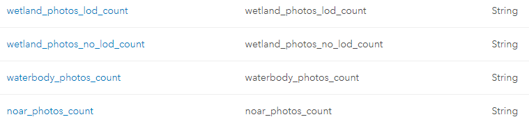

Is it possible to remove the repeat_count field that's created when publishing a survey containing a repeat_count?
I deleted these manually from my feature service on AGOL, but when republishing the survey from Survey123 Connect, it makes me add the fields again before I can publish. I would like to remove these to clean up my attribute tables on some of my more complicated surveys. I can set the bind::esri:fieldType to null for my note/calculate fields, but it doesn't seem to work for repeat groups.

That explains the _count field being generated by S123 Connect regardless of what I enter in the repeat_count field.  In an attempt to publish my survey, I have created the necessary _count field in my feature service.  However, the field name is all uppercase in my Oracle db and thus the feature service.  This is preventing my survey from publishing due to the _count field that is automatically created by S123 Connect being all lowercase:
Is there a way to control the case of the _count field that is created by S123 Connect?  Or, ignore case of the fields in the feature service when publishing?  Btw, I have tried to change the case of the field in my Oracle db, but it will not allow me to do so.
