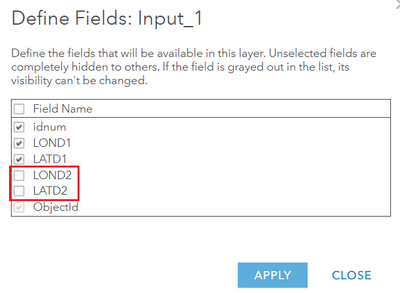

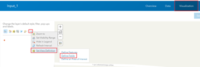

You should be able to hide the field(s) from the Hosted Layer View.
After creation of the Hosted Feature Layer View, navigate to its Item Details page, if required > Visualization tab > More Options (...) > Set View Definition > Define Fields.
Uncheck the fields that should be kept hidden.
You could use the Hosted Feature Layer View in the dashboard.
