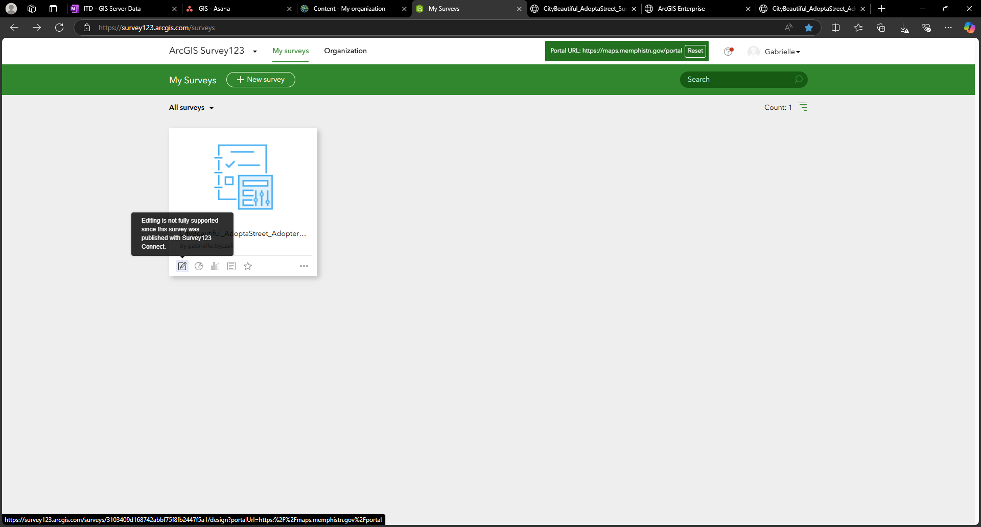

Good Morning Everyone,
Our organization is trying to connect to a survey that was created by someone else, we have changed the ownership but are still unable to access in Survey123 Connect.
This message shows up that we are unable to edit the form since it was created in Survey 123 Connect.
"Edit is not fully supported since this survey was published with ArcGIS Survey123 Connect."
I would like to know what steps I need to take so we can edit this form going forward.
Thank you

There are a number of steps you need to do to change owners of a form.  You cannot flip back and forth also.  This is more a AGOL limitation.
See my post on page 4 here for full details.
https://community.esri.com/t5/arcgis-survey123-questions/transfer-ownership-of-survey-to-another-use...
