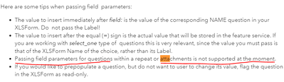

AS per this post Attachments are not supported as field parameters. Please refer to below screenshot for your reference.
