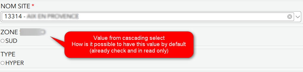

Hello,
I would like to fill the default value of the field from the value of the cascading select.
When i user "choice filter", the user see the value but have to click on it to validate.
What i want would be like a calculation that takes the value (unique of course) of the cascading select
I know there is expert here. Maybe you can help me.

The workflow is pretty simple. We have a 2-level cascading select like this one:
As you can see, two of the first level "anomaly_type" items do only have one single corresponding "anomaly_subtype" on second level.
Now, when the user selects an anomaly type in the form he still has to explicitly select the sub-type, even when there is only one sub-type for choice.
The requirement is, that in cases, where there is only one corresponding second level item to the selected first level item, this single second level item is selected/displayed directly in the survey question. This would spare the user two clicks.
