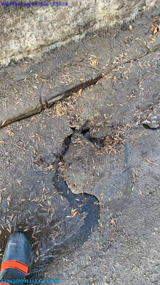

For photo stamp with date and time, use bind:esri:parameter column.
topLeftWatermark="@[datetime:ddd MMMM dd yyyy h:mm:ss]&size=20&color=grey&outlineColor=blue"
bottomLeftWatermark="@[latitude longitude]&size=20"
I was successful to add date and time as well as coordinates in the picture take from survey123.
