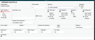

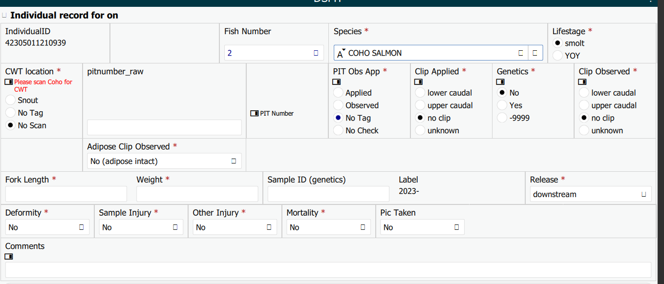

I have a s123 form (3.16.110) using repeats where users need to type entries into decimal and integer fields, then advance to the next record in the repeat (in our case, the next fish). I notice that in some cases the last field where they enter data, no values are being recorded in the data after the survey is submitted, even when they typed a value in the field in the form. It appears like when the user presses enter or tab to shift focus off of the integer field the data will pass through, but if the user just advances to the next record in the repeat (cursor still in the integer field) the data is not committed. Is there any way to commit the data when the record (repeat) advances? In this case the last "typed" data field is Sample ID.
