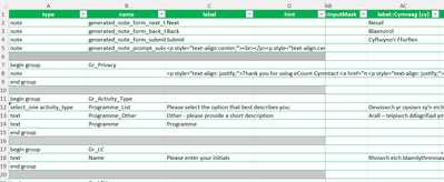

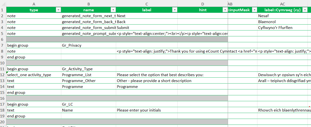

I have followed the correct steps for adding Cymraeg (cy) within my survey (see screenshot) and this appears to function correctly apart from the navigational buttons are not being automatically translated to Welsh/ Cymraeg. I also tested whether you were able to manually add translations but this also is not supported.
