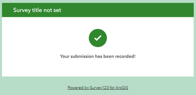

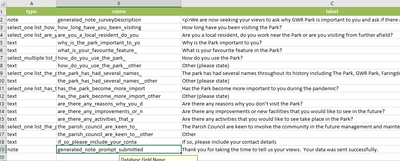

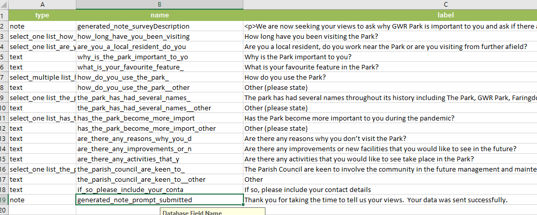

I've used the 'generated_note_prompt_submitted' note (see screen shot below), but the thank you text appears at the foot of the actual survey screen, rather than once the survey has been submitted.

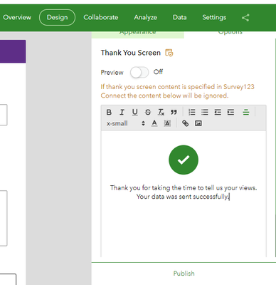

The thank you screen needs to be adjusted in the survey 123 website. I would delete the row from your survey123 connect excel sheet, adjust in survey123.arcgis.com and republish.

@HelenCooper did you ever figure this out? What I don't understand is why the message in the Web Designer says, "If thank you screen content is specified in Survey123 Connect, the content below will be ignored". This means that there is a way to configure the screen from Survey123 Connect but I have searched on many different occasions and still can't find help or instructions to accomplish it. @Anonymous User would you be able to help with this issue?

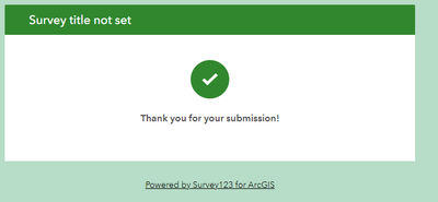

I have the same issue - when I modify the submission screen in the designer, publish the changes and then test it out, my submission screen is still the default screen. Can someone help us out with figuring this out? We are using Survey123 connect to create and publish our surveys and then go to the designer to edit the submission screen but it doesn't work and that is the only instruction for customizing the screen when using connect that we can find. @Anonymous User I have seen you respond to other chains about this topic but nothing I have read has helped me to figure this out. Can you help us? @SarahHartholt ?

Yes I understand your issue. I published my survey using Survey123 Connect. Then I changed my thank you screen in the web designer, hit the publish button and submitted a survey that displayed my new thank you screen.
