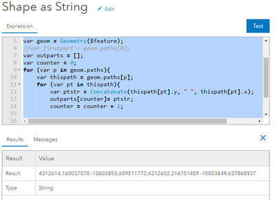

I've created a Custom URL in a webmap to pass attributes and the geometry of a line feature into Survey123. I have successfully passed the attributes, but the geometry is failing to load in Survey123. It is not a multipart line, and most have three or fewer vertices.
arcgis-survey123://?itemID=d018656fcab94a9c886edfb864f7536e&field:modelguid={wm_ElementGuid}&conductor={expression/expr0}
I am using the following code to get the geometry data:
It's from this post: https://community.esri.com/t5/arcgis-survey123-questions/survey123-with-collector-set-geotrace/m-p/7...
@JamesTedrick is there a trick or step I'm missing?
