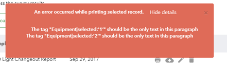

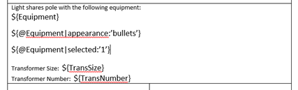

I am trying to print all selections from a multiple choice survey question into a custom report form. I've read the blog and compared it to the hint on the Survey123 Data page, but am still unable to get my selected items to print with a checkbox beside the selected items.
I've got the selected items to print as a list with commas. I've got the list to print as a bulleted list. But I can't get the checkboxes to print.
Any idea what I'm doing wrong?
the above code gets the below error.
whereas, this code works fine, but doesn't print anything with checkboxes.

Hi April,
The selected syntax is a little bit off - it should be
${Equipment | selected:'1'} Meter
${Equipment | selected:'2'} Transformer
As an FYI, the @ symbol in the field name is used when a processing step needs to access additional information not in the form's response (in the case of bullets, the full list of options).
