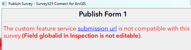

I am trying to create a Inspection form to link directly to an existing feature class. I have followed the videos and read up the documentation as to what I need to do to set this up but I am hitting a wall at the very end of the finish line. When I go to publish my survey to my existing feature service, I get this error. I want to be able to make a new inspection and pre-populate the GlobalID in the child table (Survey123) from the parent table (Collector feature service)
When I do research to what I need to do and I found that
"supportsApplyEditsWithGlobalIds" : true,
"isDataVersioned" : false Which are both correct in my rest service. Although, my GlobalID field in my survey is
"editable" : false, Which is not allowing me to publish. How can I get change this to True to allow me to publish? Maybe what steps were missed in the workflow?

JohnathanHasthorpe
Hi Sean
Can you share a bit more about the relationship that was created between the layer and table.
The parent layer should be related to the child as follows:
Parent field type = globalid - editable = false
Child field type = GUID - editable = true
Can you confirm that this is the case for your service? Share the names, types and edit status for the parent and child.
