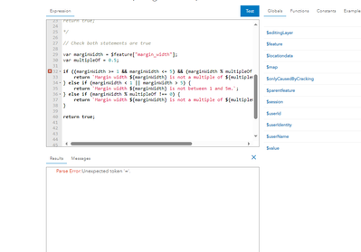

RosieLaura
HI Cody, Thanks for getting back so quickly!
It throws an error for an unexpected =
CodyPatterson
MVP Regular Contributor
Hey @RosieLaura
I had mistakenly implemented the modulus function inside of the if statement, taking some Javascript and putting it in Arcade had broken it, my bad!
Here is an adjusted function:
var marginWidth = $feature["margin_width"];
var multipleOf = 0.5;
var isMultiple = (marginWidth % multipleOf == 0);
var isInRange = (marginWidth >= 1 && marginWidth <= 5);
if (isInRange && !isMultiple) {
    return "Margin width " + marginWidth + " is not a multiple of " + multipleOf + " and not between 1 and 5m.";
} else if (!isInRange) {
    return "Margin width " + marginWidth + " is not between 1 and 5m.";
} else if (!isMultiple) {
    return "Margin width " + marginWidth + " is not a multiple of " + multipleOf + ".";
return true;
Hopefully this will get you going!
Cody
