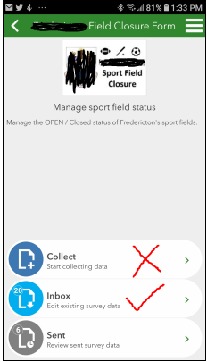

Hello,
       I am creating a survey to support the parks and rec staff to help them change the status of our sport fields from "OPEN" to "CLOSED".  When the fields are too wet for sports they must be "CLOSED".  Once the status is set messages will be triggered to social media.
         I have created a hosted feature service in AGOL that shows all of our sport fields with their name, type, address, and status.  I have set the editing to "Update attributes only".  I have created a Survey123 form that only has one question:  "Field status - OPEN or CLOSED".
        But here is my problem - when the survey is opened in the Survey123 app on a mobile device the user still has the option to choose "Collect" which will create a new record without a geopoint.  I would like my survey to be restricted to just the "Inbox" (existing records).  Is this possible??  I thought setting the feature service editing to "Update attributes only" would prevent Survey123 from creating new records.
9 Replies
BrandonArmstrong
Hi Bernie,
There is not currently a way to disable the 'Collect' option in the Survey123 Field App, however, I have added your request for this enhancement to our internal log.
One way to address the issue might be to have a select_one question as your first question, asking "Are you sure that you would like to create a new record?" All other questions could be within a Group that has a relevant applied at the group level.  If the answer is yes, the questions would appear, if the answer is no, you could have a message asking the submitter to exit the survey and direct them to open the Inbox.
