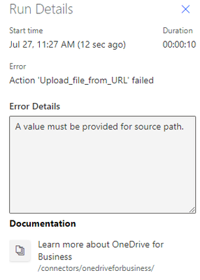

I'm using this guide from @IsmaelChivite  here but I'm running into an error with the Upload file from URL action. The flow will run perfectly upon initial set up but now I'm receiving this error when it runs.
Any reason why it would fail after running successfully? Any help is appreciated.

This error indicates that the Create Report action failed to generate a report.   In Power Automate, check the Create Report tool output and look for the error message. That should give you more info about what is going on.

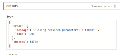

Hey @IsmaelChivite, I checked the Create Report tool and the error message states "Missing required parameters: \"token\"".
It appears that my Survey123 connection for the Create Report tool times out after some time and a new connection  has to be created. Is this typical and is there any workaround to this?
