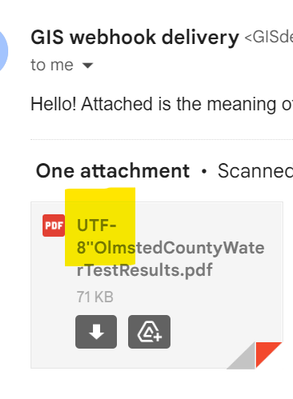

Is there anyway to stop the create report from adding UTF-8 to the file path when generating a report?
What does this mean? And where does it come from?

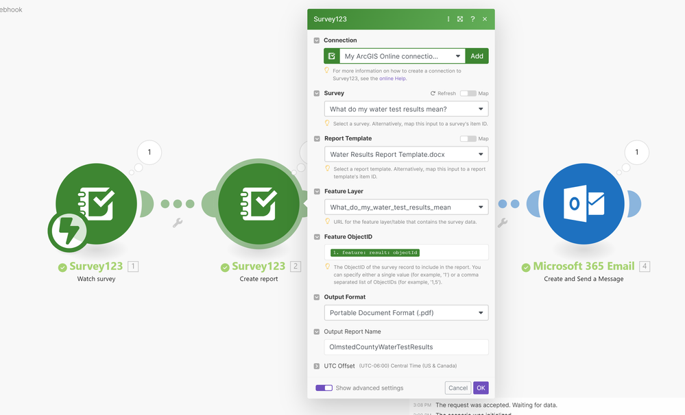

Currently using Make to watch the survey, create report, get a file (http), and create and send the report to the submitter via email M365.
This may be confusing for the citizens receiving their report, so trying to see how I can remove.

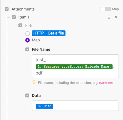

Hi Teresa, I found a solution buried in another ESRI support thread.  When you are using the Microsoft 365 Email component to distribute your report, choose to Map the file instead of HTTP-Get a File.  Name the file as you would normally using dynamic attributes from the survey results.  Be sure to include a file suffix at the end such as .pdf or .docx.
Hope that helps.
