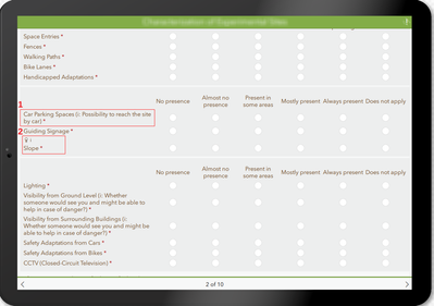

How do you create a table-list within a group with a bunch of questions that share a select_one question, like in the screenshot below?

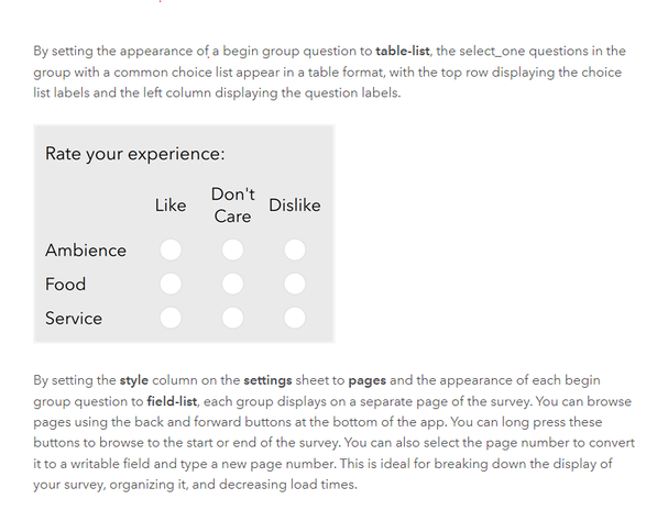

It's called a single select grid now I think.  You use table-list appearance
See here  https://doc.arcgis.com/en/survey123/browser/create-surveys/quickreferencecreatesurveys.htm#ESRI_SECT...
It was hard to find for some reason.  Hope that helps
ZenMasterZeke
One caveat is that you can't have a conditional question right after the select question. For example, if a user selected 'Dislike' above, you may want a text question to display asking for details about what they didn't like. While you can have these outside the table-list, you can't have them directly after the select question.
