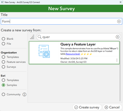

It wouldn't be in a single line the calculation would need to go in it's own question so that value can be referenced in the event select_one question. The separate question can be a calculate question type that is not visible on the form and is only used to store calculations on the back end.
Another good resource to see how to summarize data using pulldata("@layer") in XLSForm is the Query a feature layer sample available in Survey123 Connect.
