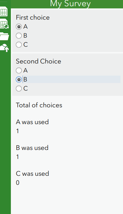

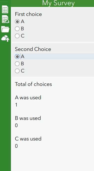

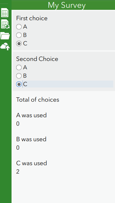

I'm trying to count the number of times a choice has been selected across many select_one questions.
as an example
The count works when only one instance is chosen, but fails to add values.

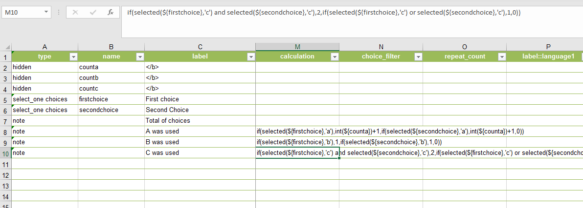

I realise this is due to the use of the 'if' statement as a control.
However if i use
if(selected(${firstchoice,'a') and selected(${secondchoice},'a'),2,if(selected(${firstchoice},'a') or selected(${secondchoice},'a'),1,0) it does work. (used for option 'c' above)
This solution is okay if there are only 2 options, however I want to count the number across 23 questions and the if statement would have 100's of permutations to enter.
There must be a better way.
I have tried using hidden fields as variable to hold the count, which doesn't work, (as in the first note field above), but i cant get the addition to work.

I've solved it...
simply used an if statement to assess which option is selected then added up each answer
if(selected(${firstchoice},'a'),1,0)+if(selected(${secondchoice},'a'),1,0)
if(selected(${firstchoice},'b'),1,0)+if(selected(${secondchoice},'b'),1,0)
if(selected(${firstchoice},'c'),1,0)+if(selected(${secondchoice},'c'),1,0)
rookie mistake.....tried to over complicate it
