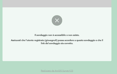

I don't know if the problem we are experiencing is similar to the one of vijaybadugu but ghere is the problem: we published a Survey that is perfectly working when accessed via mobile app.
When we try to use it from the Survey123 website, sometimes (not always!) we get a CORS error (sometimes more than one):
(translation:
Multi-origin request blocked (cross-origin): the source match policy does not allow reading of the remote resource from https://sinacloud.isprambiente.it/arcgisadv/rest/services/Hosted/service_79182d0128094781841256da6fc3d3ed/FeatureServer/6?f= json&token=Bo3F
And of course the survey is not accessible:
The weird thing is that if we refresh the page, sometimes it works perfectly, and up to now we cold not tell the reason.
The Enterprise we are using is a 10.9.1 version, the feature service is hosted. The survey website was added on the trusted sited of the portal, no CORS policy is present on any webserver or on the portal.
