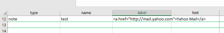

Thanks Doug. That is what I concluded after trial and error yesterday. I think I also discovered a way to insert that note into the thank you screen, but the URL will not be hyperlinked unless I am missing something.
I want to make sure that folks do not forget to click the submit button so may hide the note until the thank you screen... If all that works, my next step will be to figure out how to use a web hook to send the submitter an email summary of the info that they submitted, including the web page address. If you happen to know how to do that as well, I would appreciate any info you can provide.
