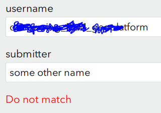

Are you sure the list matches the username exactly?  Display it to make sure.
This works fine for me.  Using a note with a relevant on it.  I use this for inline warnings a lot.
Hope that helps

Hi Doug,
Perfect, thank you for that! The values were definitely matching and I thought that was the correct syntax, so not sure why I was getting errors inconsistently yesterday. And the syntax for relevant is really helpful, thank you! 🙂
