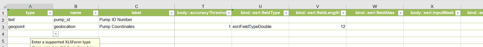

If you use Survey123 Connect for ArcGIS, you can add a geopoint type that will collect the coordinates of each pump as the data collector clicks on either the map or point icon when near the pump and fills in the pump id information in the survey. The illustration below has a 1 meter threshold.
Survey123 Connect example of adding a geopoint
Hope this is what you're looking for.
