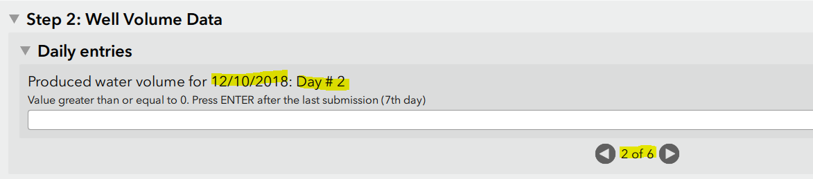

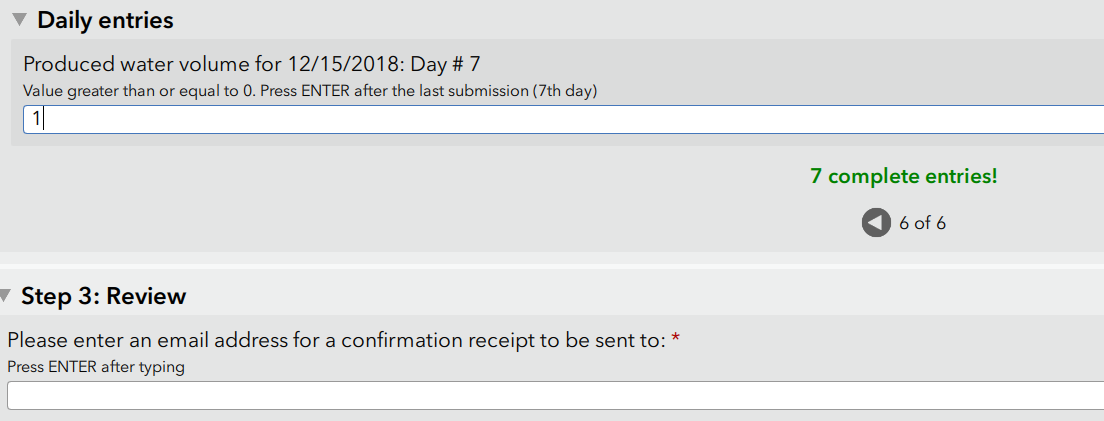

Connect (works)

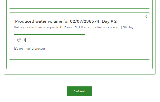

Web (does not work)
Question 2: Why is the relevant statement not working to open "Step 3" Group? Do repeat counts work (or numbered) the same way in both Connect and web form? It looks like in Connect it starts at "0" count and on the web form "1"...?
