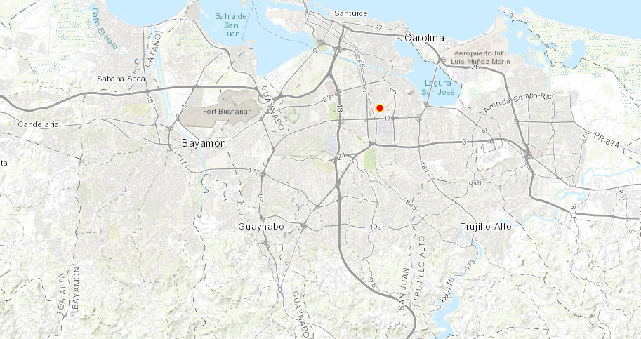

Hello,
I would like to know if is possible to configure the image of the map when I export a report in survey123.arcgis.com for a larger scale.
this is my default scale in the report

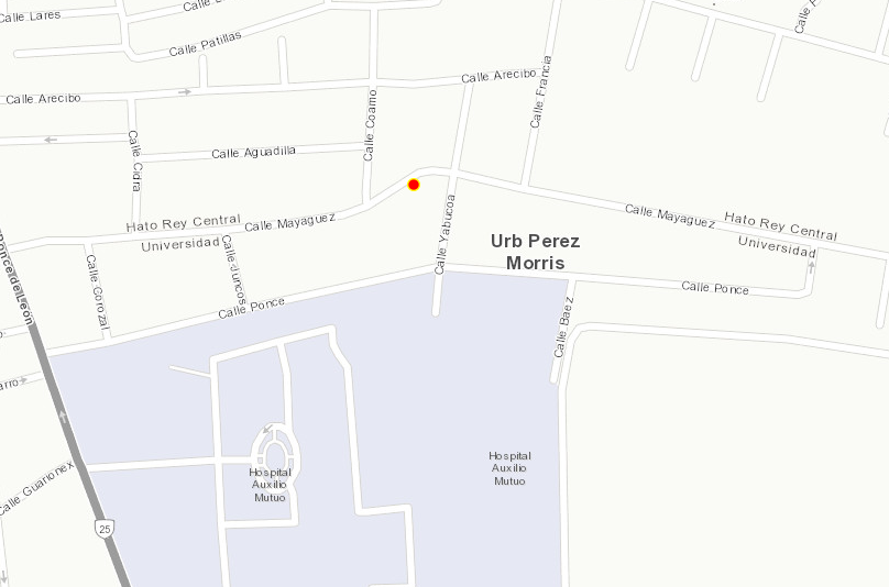

And i would like that by default this scale be shown
is it possible? how can this be reach?

Hi Diego,
The feature report service defaults to the form's default scale, which can be controlled through Survey123 Connect or the web designer.  You can override the default map scale in a report through the mapSettings properties in the report.  Refer to Feature report templates—Survey123 for ArcGIS | Documentation .
