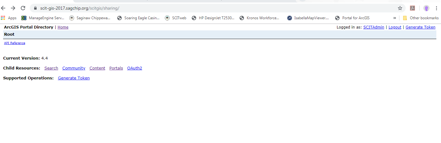

The following is what appears

It appears you don't have the full path as specified.  You are at:
https://scit-gis-2017.sagchip.org/scitgis/sharing/rest/content
You should be at
https://scit-gis-2017.sagchip.org/scitgis/sharing/rest/content/users/<username>
Where <username> is your portal username

When I login as that user the only supported operation is Generate token

When you try manually typing the path, are you redirected to the sharing home?  I wouldn't expect this to be browsable.
