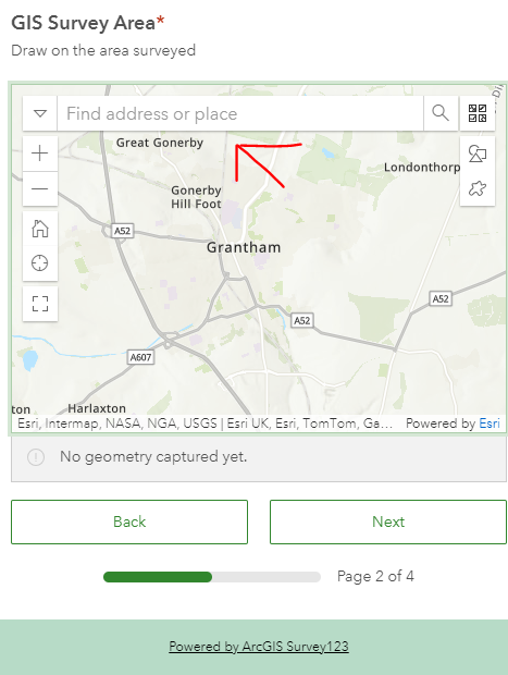

I have a survey123 form created in connect that I am embedding in an experience builder application. In this map users may need to search for a location anywhere in the UK and will require to search by a project code or name.
Is it possible to configure the below embedded maps search bar the same way you could do in experience builder search bars in survey123 connect to allow the users to search by a custom feature layer? The form has to be curated in connect due requirements

No.
If that is within S123, then you cannot configure that like you can Experience Builder. It is still S123, just embedded in a web page/map

EdHixson
Yeah that makes sense
So there is definitely no way you can do in the browser version of Survey123?
abureaux
MVP Frequent Contributor
Nope. That search bar is that search bar, regardless of which "version" you are using.
It sounds like this isn't a possibility in your situation, but you can of course embed the survey within experience builder and then link the EB map to the embedded survey. In that case, you can filter the data however you'd like, and then launch into the survey, passing data as required.
