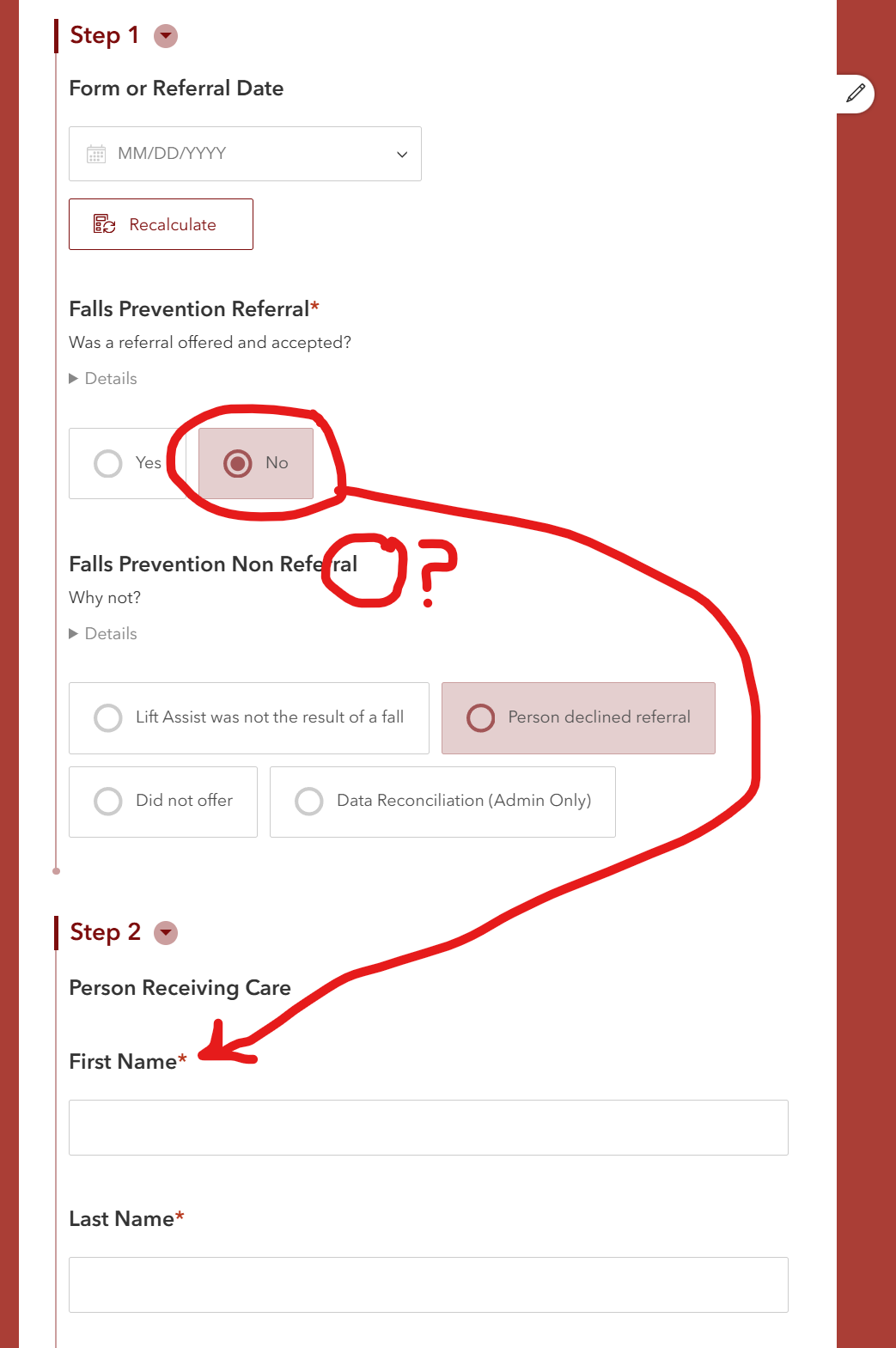

Survey123 Connect form: I'm noticing really odd behaviors between the conditional required, relevant, esri:visible fields that is really throwing me for a loop.

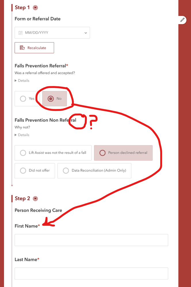

I have a conditional required question: if referral = yes, then name and date of birth are required. Pretty simple.
However it's requiring it no matter what and when I say required referral = no for another question - it doesn't add a requirement. I'm totally perplexed.
I tried if(${field} = 'Yes','yes','') or selected(${field},'Yes'). Nothing seems to get it to behave correctly. I tried adding recalculate url parameters (web form url embedded in Dashboards in edit mode).

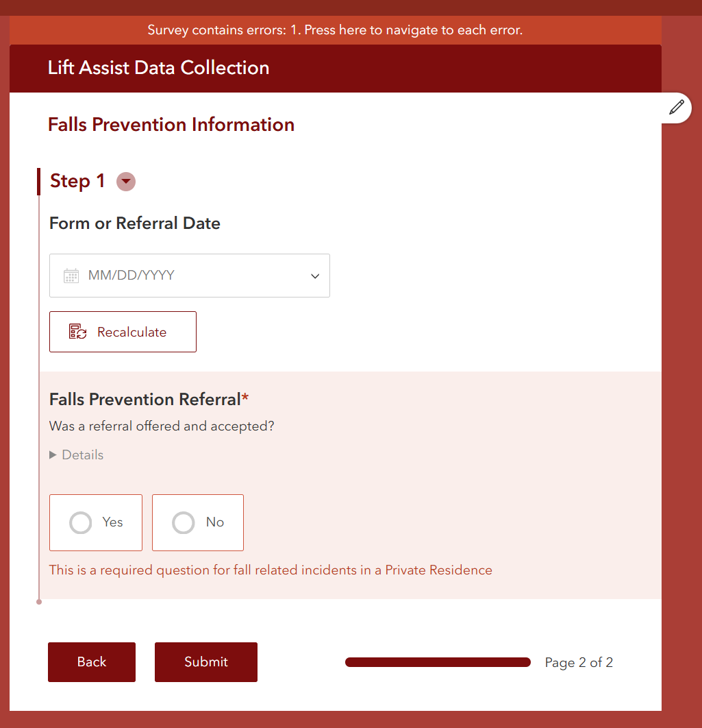

I'm also noticing my required messages are showing before anyone has had a chance to answer the question. Like as soon as relevant or esri:visible is true. And it's announcing them as survey errors at the top when a new conditional required question is shown, especially when navigating page to page.
I'm sure I'll ask someone to put an esri ticket in for me, but figured I'd start here.
Attached is my XLM form (service urls removed). Is there something I'm doing wrong between the required, relevant, esri:visible fields? Like some rule I don't know about? Like esri:visible and required don't mix? I have multi level groups and pages and maybe there's something I'm missing. I'm using esri:visible because there are some questions that I need to calculate even when their not relevant.

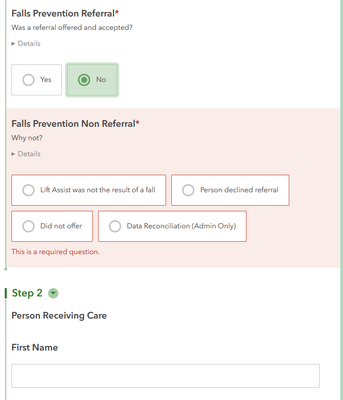

Pictured is right after I got to this page (page 2 of 2), automatically showing errors:
That seems weird! Like, sure once I click submit for this page, show the errors.. but not before???

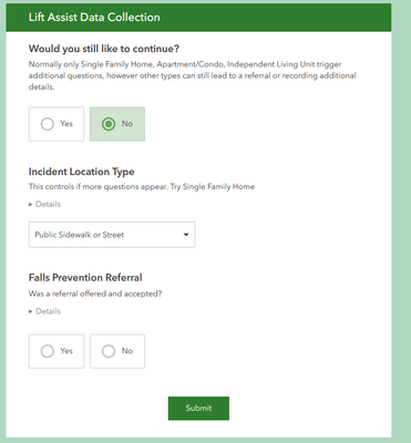

I see no issues in Connect OR the Web Form (examples below). You sure you are selecting the correct options while testing?

I had to isolated the issue to just a few questions, and so deleted everything unrelated to the issue. You have capitals in the name column, so I can't publish as-is (Enterprise doesn't support capitals in the name column when published from Connect directly). I also am not familiar with how things conditionally show/hide, so there isn't much point playing hide and seek with the few questions I am looking for. That is why it looks different.
I was really just testing the conditional nature of ${FALLS_PREVENTION_REFERRAL} in that test.

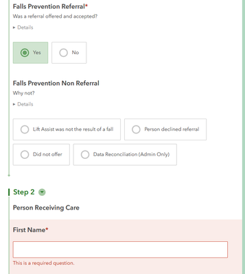

This time, I kept as much as I could for the test. I still had to replace all the names (can't be avoided if I want to publish the form), as well as remove the data on the settings tab (this one can't be avoided by anyone), and a few unrelated fields. Again, will look different from yours, but the logic for the required column is untouched.
This appears to we working as intended.

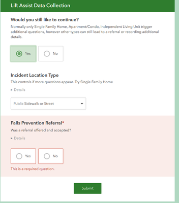

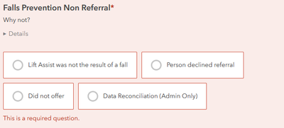

Are you saying that the issue is simply the red showing up? Aka, this:
If so: No, that is not a bug. That is "working as intended". The web app just marks questions that way when they are conditionally shown.

Requirement messages really are only supposed to display upon clicking "submit" or clicking "next" - not just when the question is revealed. That's how they behave on all of my other surveys. This is the first survey I've tried using the esri:visible field to help control visibility and this is the first time I'm running into this issue. And actually this behaves correctly sometimes for the first page if certain answers are given.

Hmm. As I mentioned, I didn't touch the "required" logic, so it should be the same on both our Web Forms (as that is a universal base). The only real difference is Connect. Maybe try updating Connect to the more recent version and see if republishing impacts behaviour then.
Web form is a little odd. When you conditionally make a thing required, it shows the red "required" appearance. It has been this way for a while now. I do agree that it seems odd as that deviates from standard behaviour though. While in the Field App though, the "required" fields behave as expected.
