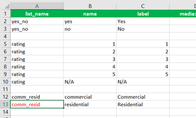

Quick question, my commercial or residential question doesn't work. It only shows commercial. I' ve tried changing the appearance to minimal and regular horizontal but that didn't work either. Could you please see if you're getting the same issue? Thanks.

In Choices tab, A13 is empty. Please fill with appropriate value as shown below.

AliciaShyu
Thanks Jayanta!
