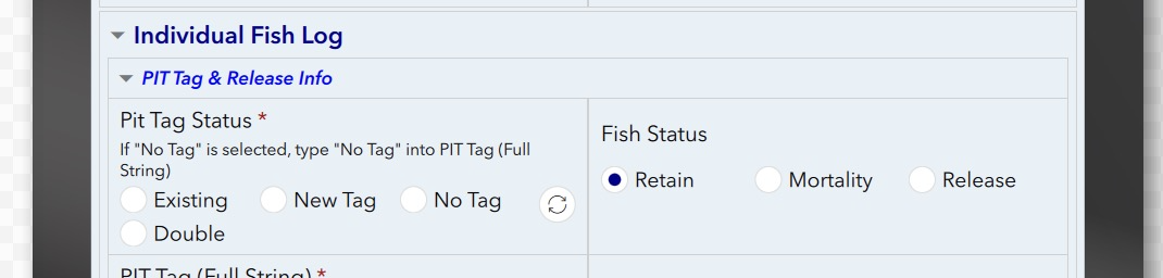

Is this a bug? Or am I doing something that's causing this? My XLS form is attached. Please also see the attached screenshot for an example of one select_one question that is required (Pit Tag Status) and won't calculate unless I hit the refresh button while the other select_one question (Fish Status) auto calculates.

I was able to repro. The problem is the combination of repeats, required and calculations. The attached XLSForm illustrates the problem. A 'required' 'select_one' within a 'repeat' will not automatically calculate. I shared this internally within the team. However, logging this is a BIG via Esri Tech Support will help others track it.
This has been documented BUG-000147586 - Required questions in repeat not receiving calculation on form load

Hi @IsmaelChivite That bug specifies the problem for integer and decimal questions and that the question be required and read only in Apple iOS. At least the description I can see.
Can you confirm that the tech support team knows the calculation is also not being passed through for select_one questions that are required but not read only? Basically it seems a bit more widespread than the bug description, which is over a year old. The suggested workaround of removing the required flag does work, but I (obviously) do not have the option of changing the question type to note. At the same time, removing the required flag is undesirable.
This can be replicated in Survey123 for Windows, Android, and iOS as well as the testing interface of Survey123 Connect for Windows. I work for a government organization.
