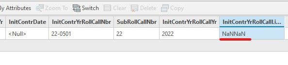

But when you view the data in the feature service, the data is different.
That's a text field with 255 characters.
Any ideas why it works in Connect but not in the webform?

You cannot use the + on strings in the web form.  You can only use concat.  No need for the string() part.
Just concat(string1, string1, ...)

That worked, thanks!
