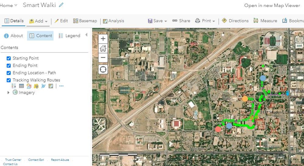

Hello Philip,
Thanks for the answer. Actually, in my web map, I added a Location Tracking feature layer and one point feature layer for starting point, and one point/line feature layer for ending location along with survey 123 hyperlinks,
So, I already have a Location Tracking layer in my web map.but, it doesn't track the path, It has point layers so, I had to submit for all the points. which is not suitable,
I need to have a tracking layer that is automatically recorded path/track like (Garmin GPS).
I want to ask participants to mark the starting point so that their path automatically records then they submit their ending destination/ location.
I attached my web map, yesterday,I did use it and in every 4 meters, I submit location tracking points which are in green color.
Thanks in advance
Best,
Gisou

@Gisou,
As it appears your question is more of a web map or Collector/Field Maps issue related to tracking, I would suggest posting in the relevant forum, as there are more experts in those forums related to the issues and questions you are encountering.
Regards,
Phil.
