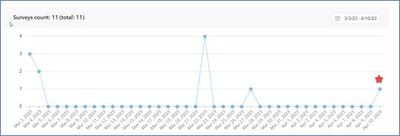

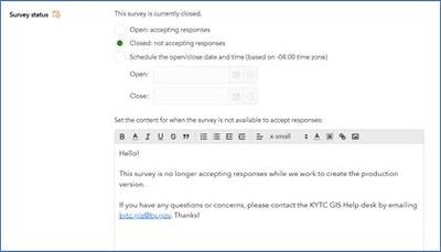

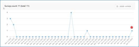

We have a S123 that was closed a few weeks ago as we have since deployed the production version.  I checked when it was closed and the survey would not allow responses through the webform or app (as expected).  We had a record come through this morning, however, from the test survey.  I checked and all of the settings are still set to close the survey – including requiring an update to the latest survey and using the latest version of S123 (other troubleshooting tips / suggestions).  I cannot submit a record through the webform but I can now submit records through the application.  I found the thread linked below but there was no solution for it – just guidance to email this in (done, but I wanted to see if anyone else had found a solution).

The survey was authored using 3.16 but requires an update to the latest survey and is set to use the latest version of 3.17.

I know you had emailed this in and James had responded, the open/close survey setting is only applicable to the Survey123 web app and does not apply to the Survey123 field app
As an alternative workflow you can update the description for the survey in Connect to note that the form has been deprecated and disable editing on the feature service the survey points to.
