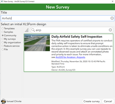

Yes. In Survey123 Connect check the Airfield Sample. The shift is calculated automatically based on the current time.

Thank again, my issue has been resolved and the Daily Airport Inspection template works fine...
