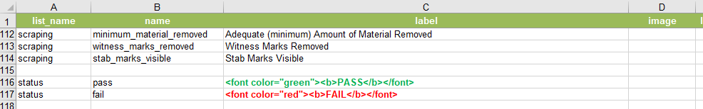

I am noticing that for a survey I created, the results in the backend for my choice selection is displaying the Label result and not the Name result. Here is an example:
The image below is a copy of my spreadsheet's "Choice Tab," where you can see two choices for "status," pass and fail.

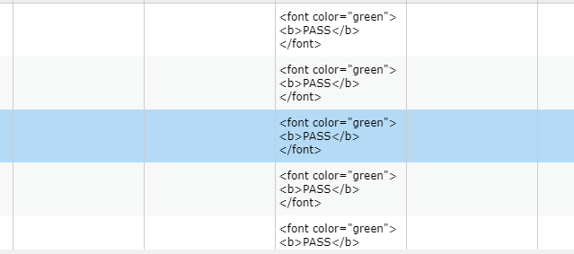

In the name field, I have pass and fail as my two options, with the label coloring them so Pass is green and Fail is red in my survey. However, in the backend, the results for my choice selection show up like this:
Why isn't it using the results from the name field like it does for every other question in my survey?
