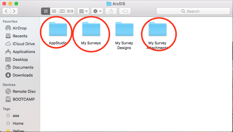

But, I noticed that all the underlying data (i.e. databases, attachments, survey templates) are saved onto the individual’s user profile “C:\Users\Username\ArcGIS\”
And I was wondering if it is possible to change this path (C:\Users\Username\ArcGIS) to a shared folder?
Otherwise, I could possibly move the “ArcGIS” folder from “C:\Users\Username\ArcGIS\” to Dropbox. I.e. - create a symbolic link from the “ArcGIS” folder in Dropbox into the old location (C:\Users\Username\ArcGIS). By writing the following in command prompt (for example)
$ mklink /J C:\Users\Username\ArcGIS C:\Users\Dropbox\ArcGIS
I haven’t been brave enough to try out the “symbolic link” option yet. But, I was wondering if anyone else could come up with an easier solution.

It is not possible to hard change the C:\Users\Username\ArcGIS path to a shared folder, we do expect you to be able to use the symbolic link.
