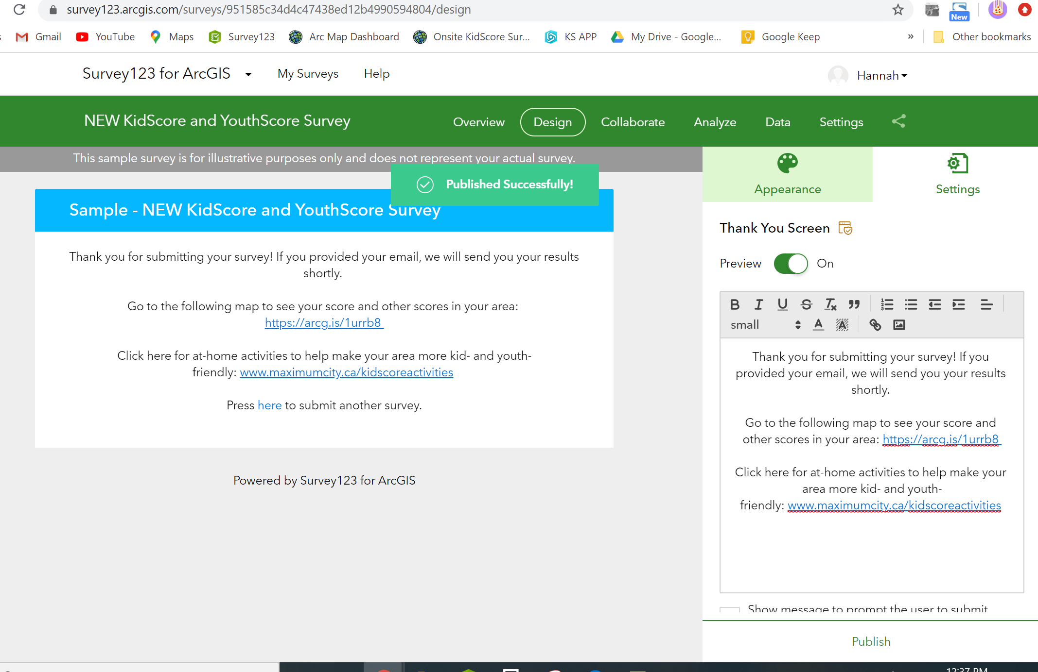

HannahMiller1
Hi Zhifang,
Thank you for this thread above! After ensuring my survey is running on the most recent version, and clearing my cache, I am still having an issue updating my "Thank You" page. I am changing the text and publishing, but when I refresh, the old thank you text returns.
Survey link: https://arcg.is/G5bmz
Attempt at new text - see the "Published Successfully!"
After refreshing the page, the old text returns:
Any help would be greatly appreciated!

ZhifangWang
Hi Hannah,
Thanks for your feedback.
We have identified a similar issue that changing the thank you screen content and publishing the survey does not take effect for some Connect surveys, this has been fixed on our beta website now. Would you mind trying to change/publish your survey there https://survey123beta.arcgis.com to see if it works for you?
Thanks,
Zhifang
