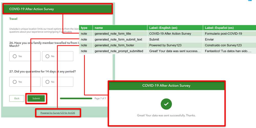

Hi @CA_-_ReneGonzalez__GISS_  Yes. It is possible. You can do that by adding a note question in your survey. The name of the question needs to be 'generated_note_form_submit_text'. The label in that question defines the text that will be displayed in the Submit button.
Please note that this only will take effect in the Survey123 web app, since the field app does not use any text in the submit button.

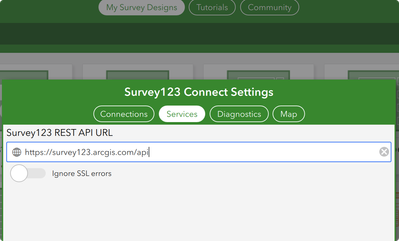

To make the special note question work as the text of the submit button in the Survey123 web app, several certain conditions need to be met. Would you mind checking if all of the following are correct?
  • Use the latest 3.11 Survey123 Connect (the version number should be 3.11.123)
  • In Survey123 Connect, use "https://survey123.arcgis.com/api"  in Settings->Services as the Survey123 REST API URL
  • In XLSForm, for the note question, use "generated_note_form_submit_text" for the name column and the expected text for the label column. Note: if you set the text in other columns e.g. hint, it will not work.
